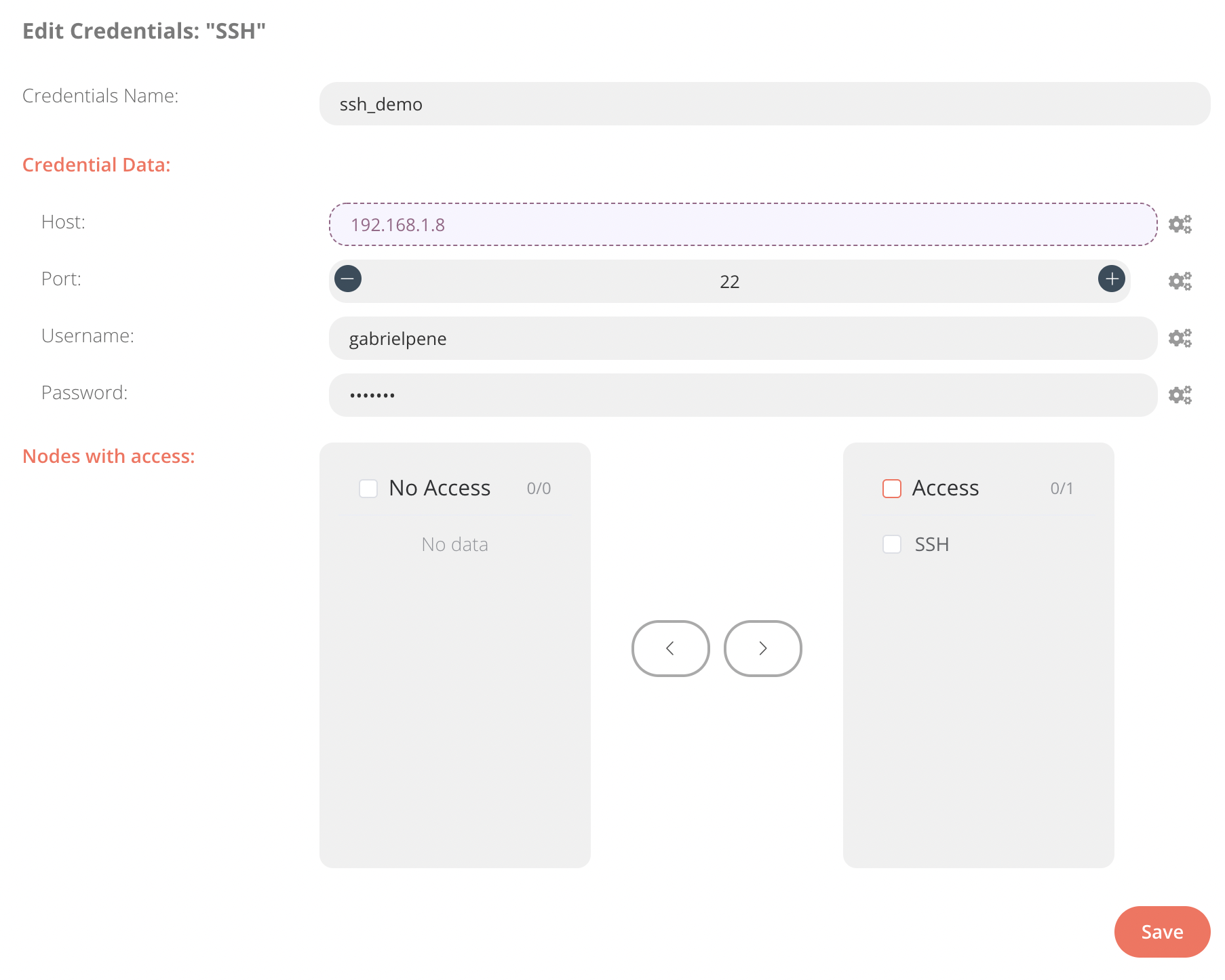

## Using password <a href="#using-password" id="using-password"></a>
Use this method if you have a user account that can `ssh` into the server using their own password.
To configure this credential, you'll need to:
1. Enter the IP address of the server you're connecting to as the **Host**.
2. Enter the **Port** to use for the connection. SSH uses port `22` by default.
3. Enter the **Username** for a user account with `ssh` access on the server.
4. Enter the **Password** for that user account.
