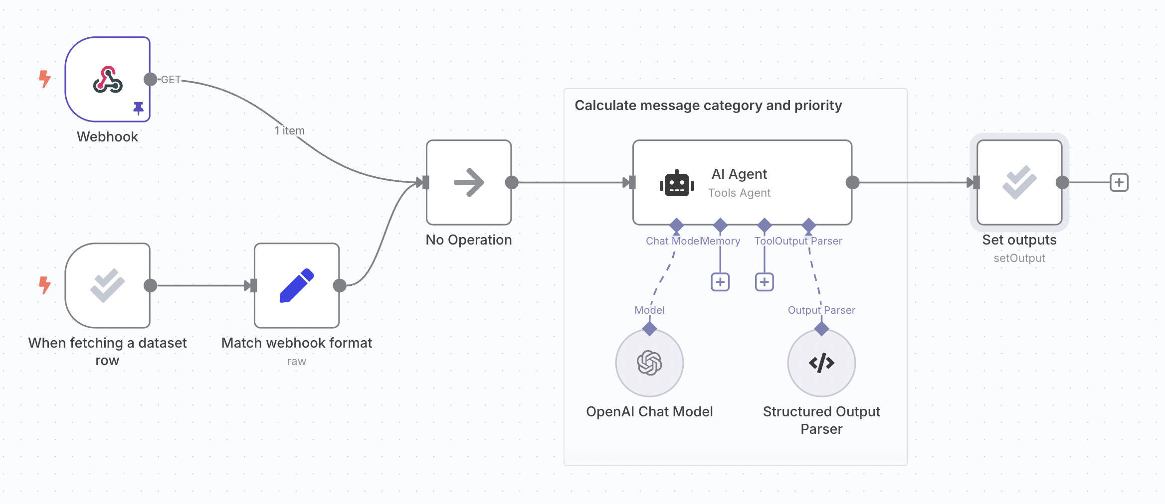

The following steps use the same support ticket classification workflow from the light evaluation docs:
![Light evaluation workflow](https://3488703508-files.gitbook.io/~/files/v0/b/gitbook-x-prod.appspot.com/o/spaces%2FrPN1zU5jaYNvwH7RzxqA%2Fuploads%2Fgit-blob-29f512965cdeac59b4bb2935185ac570dfe2ca5e%2Flight-evaluation-workflow.png?alt=media)

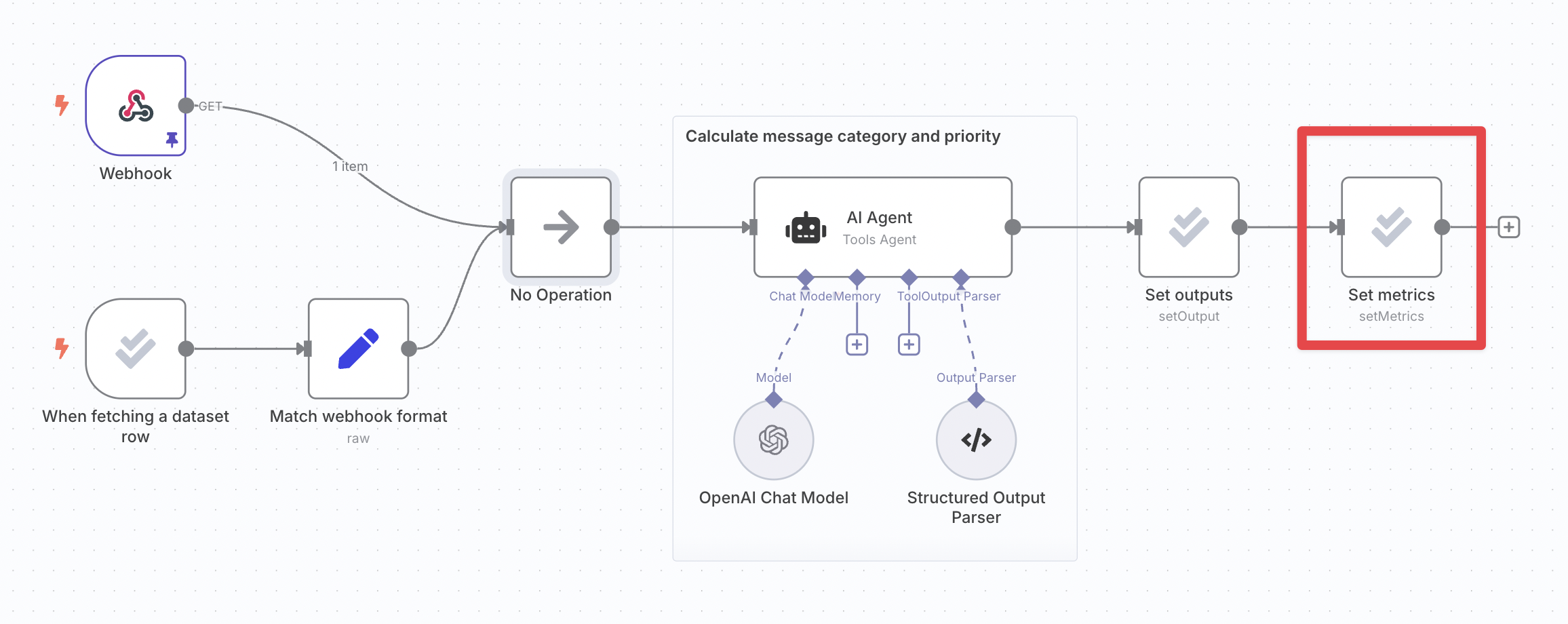

Use the **Set Metrics** operation to calculate:
* **Correctness (AI-based)**: Whether the answer's meaning is consistent with a supplied reference answer. Uses a scale of 1 to 5, with 5 being the best.
* **Helpfulness (AI-based)**: Whether the response answers the given query. Uses a scale of 1 to 5, with 5 being the best.
* **String Similarity**: How close the answer is to the reference answer, measured character-by-character (edit distance). Returns a score between 0 and 1.
* **Categorization**: Whether the answer is an exact match with the reference answer. Returns 1 when matching and 0 otherwise.
* **Tools Used**: Whether the execution used tools or not. Returns a score between 0 and 1.
You can also add custom metrics. Just calculate the metrics within the workflow and then map them into an Evaluation node. Use the **Set Metrics** operation and choose **Custom Metrics** as the Metric. You can then set the names and values for the metrics you want to return.

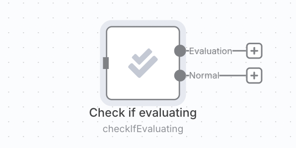

Calculating metrics can add latency and cost, so you may only want to do it when running an evaluation and avoid it when making a production execution. You can do this by putting the metric logic after a ['check if evaluating' operation](https://docs.n8n.io/integrations/builtin/core-nodes/n8n-nodes-base.evaluation.md#check-if-evaluating).
![Check if evaluating node](https://3488703508-files.gitbook.io/~/files/v0/b/gitbook-x-prod.appspot.com/o/spaces%2FrPN1zU5jaYNvwH7RzxqA%2Fuploads%2Fgit-blob-2e5c4318407d2f10f324d6cb9188aaad45a420b1%2Fcheck-if-evaluating.png?alt=media)

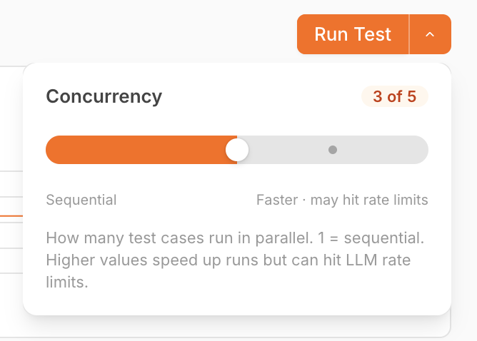

On plans that support concurrency, **Run Test** is a split-button. The caret to the right opens a popover with a slider that controls how many test cases run at the same time.
<figure><img src="https://3488703508-files.gitbook.io/~/files/v0/b/gitbook-x-prod.appspot.com/o/spaces%2FrPN1zU5jaYNvwH7RzxqA%2Fuploads%2Fgit-blob-6f6c0526d8add839d4c0bfedeef85eddc7c442db%2Frun-test-concurrency.png?alt=media" alt=""><figcaption><p>The concurrency popover, with the slider at 3 of a maximum of 5 parallel test cases.</p></figcaption></figure>

{% hint style="info" %}
**LLM rate limits**
Higher concurrency speeds up evaluation runs but increases the chance of hitting upstream LLM rate limits. If you see rate-limit errors, lower the slider.
