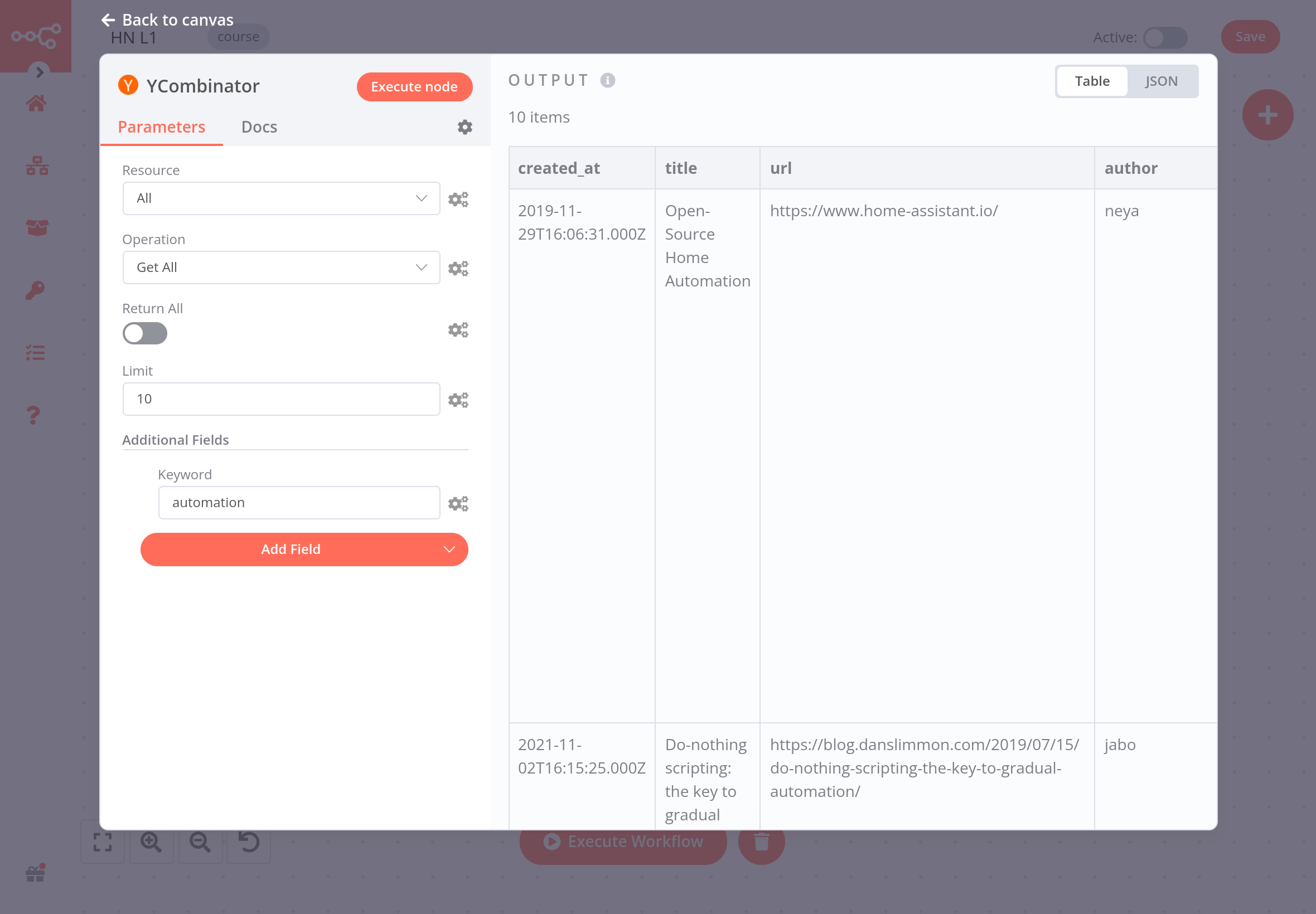

We need to configure several parameters for the Hacker News node to make it work:
- Resource: All
This resource selects all data records (articles). - Operation: Get Many
This operation fetches all the selected articles. - Limit: 10
This parameter sets a limit to how many results the Get Many operation returns. - Additional Fields > Add Field > Keyword: automation
Additional fields are options that you can add to certain nodes to make your request more specific or filter the results. For this example, we want to get only articles that include the keyword "automation."
The configuration of the parameters for the Hacker News node should now look like this:
![Hacker News node parameters](/_images/courses/level-one/chapter-two/l1-c-2-hacker-news-node-parameters.png)

4. Execute the node#
Select the Test step button in the node details window. You should see 10 results in the Output Table view.
![Results in Table view for the Hacker News node](/_images/courses/level-one/chapter-two/l1-c2-results-in-table-view-for-the-hacker-news-node.png)

If the parameters are configured correctly and everything works fine, the requested data displays in the node window in Table, JSON, and Schema format. You can switch between these views by selecting the one you want from the Table|JSON|Schema button at the top of the node window.
Table vs JSON views
The Table view is the default. It displays the requested data in a table, where the rows are the records and the columns are the available attributes of those records.
Here's our Hacker News output in JSON view:
![Results in JSON view for the Hacker News node](/_images/courses/level-one/chapter-two/l1-c2-results-in-json-view-for-the-hacker-news-node.png)
The node window displays more information about the node execution:
- Next to the Output title, notice a small icon (this will be a green checkmark if the node executed successfully). If you hover on it, you'll get two more pieces of information that can provide insights into the performance of each individual node in a workflow:
- Start Time: When the node execution started
- Execution Time: How long it took for the node to return the results from the moment it started executing
- Just below the Output title, you'll notice another piece of information: 10 items. This field displays the number of items (records) that the node request returned. In this example, it's expected to be 10, since this is the limit we set in step 2. But if you don't set a limit, it's useful to see how many records are actually returned.
