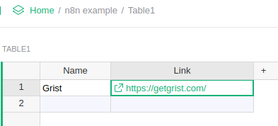

And here's the result of adding the record to the Grist table:
The example table after creating a new record with the Grist node

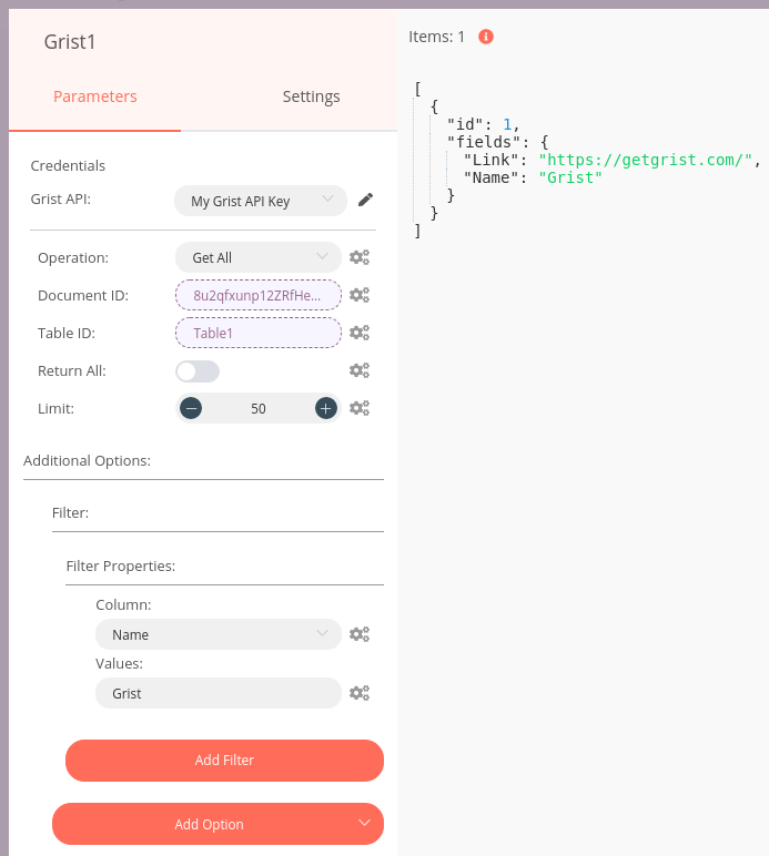

3. Grist1 node (Get All)#
This node will list all the records with a particular Name value.
  1. Select the credentials that you entered in the previous node.
  2. Select the 'Get All' option from the Operation dropdown list.
  3. Click on the gears icon next to the Document ID field and click on Add Expression.
  4. Select the following in the Variable Selector section: Nodes > Grist > Parameters > docId.
  5. Click on the gears icon next to the Table field and click on Add Expression.
  6. Select the following in the Variable Selector section: Nodes > Grist > Parameters > tableId.
  7. Click on Add Option and select 'Filter' from the dropdown list.
  8. Click the Add Filter button.
  9. Select Name from the Column dropdown.
  10. Type a name in the Values field.
  11. Click on Execute Node to run the node.
In the screenshot below, the node only returned the record with the name 'Grist':
Using the Grist node to read data from an Grist table
