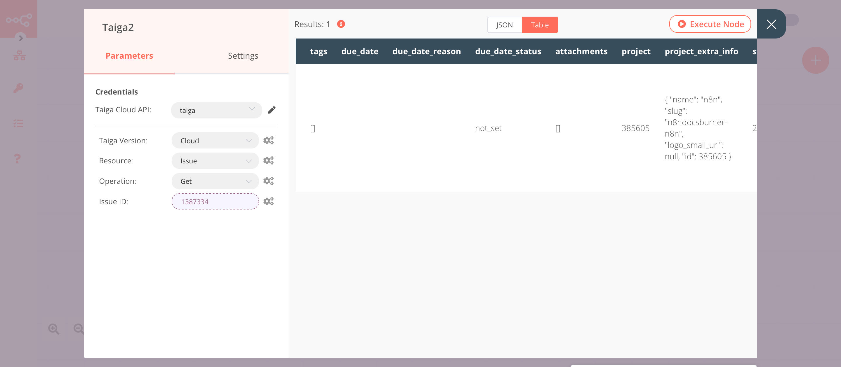

4. Taiga2 node (get: issue)#
  1. Select the credentials that you entered in the previous node.
  2. Select 'Get' from the Operation dropdown list.
  3. Click on the gears icon next to the Issue ID field and click on Add Expression.
  4. Select the following in the Variable Selector section: Nodes > Taiga > Output Data > JSON > id. You can also add the following expression: {{$node["Taiga"].json["id"]}}.
  5. Click on Execute Node to run the node.
Using the Taiga node to get an issue
