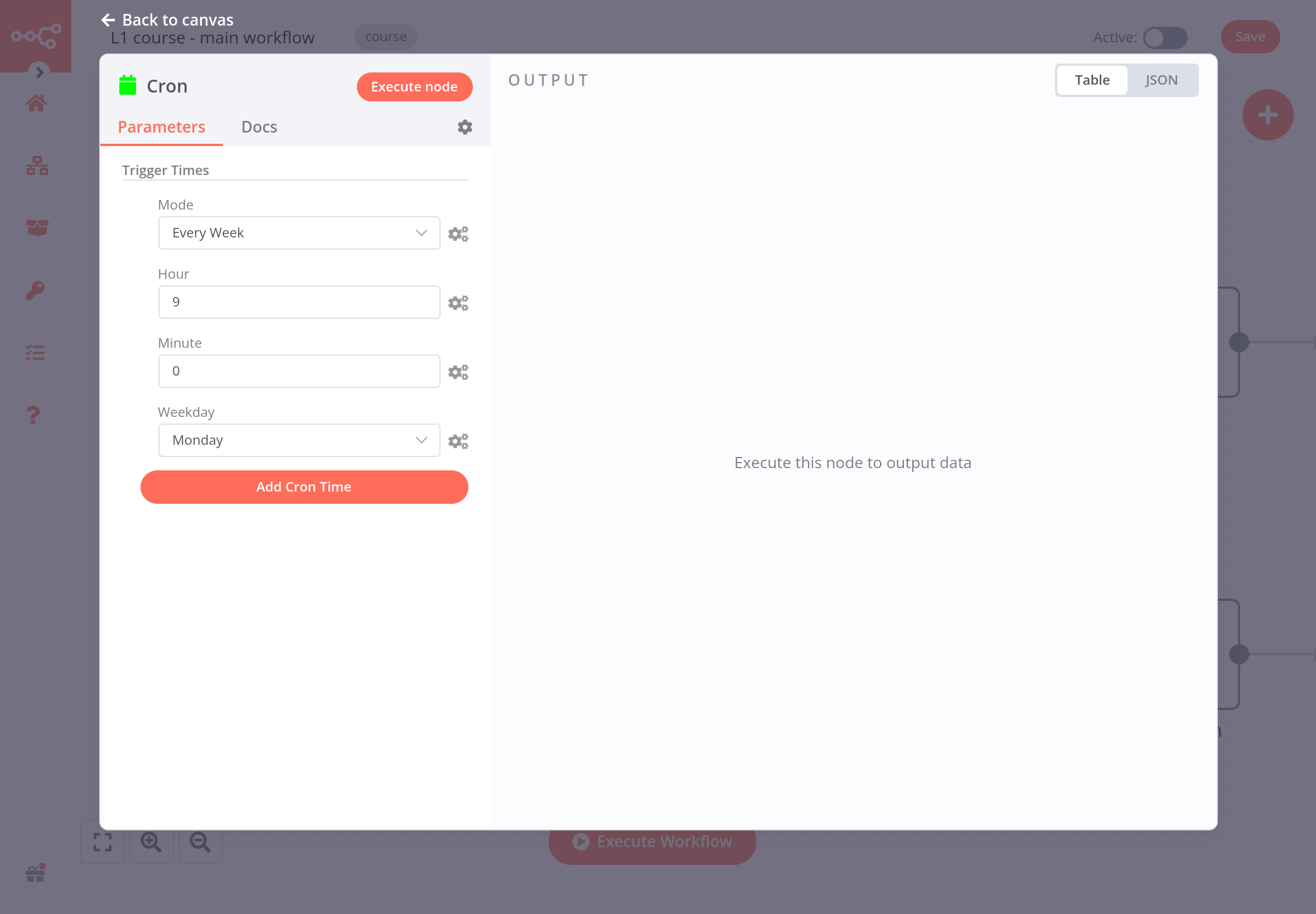

The workflow you've built so far executes only when you click on Execute Workflow. But Nathan needs it to run automatically every Monday morning. You can do this with the Schedule Trigger, which allows you to schedule workflows to run periodically at fixed dates, times, or intervals.
In your workflow, add the Schedule trigger node, and configure its parameters:
  • Trigger Interval: Every Week
  • Weeks Between Triggers: 1
  • Trigger on weekdays: Monday
  • Trigger at Hour: 9am
  • Trigger at Minute: 0
Schedule Trigger Node
