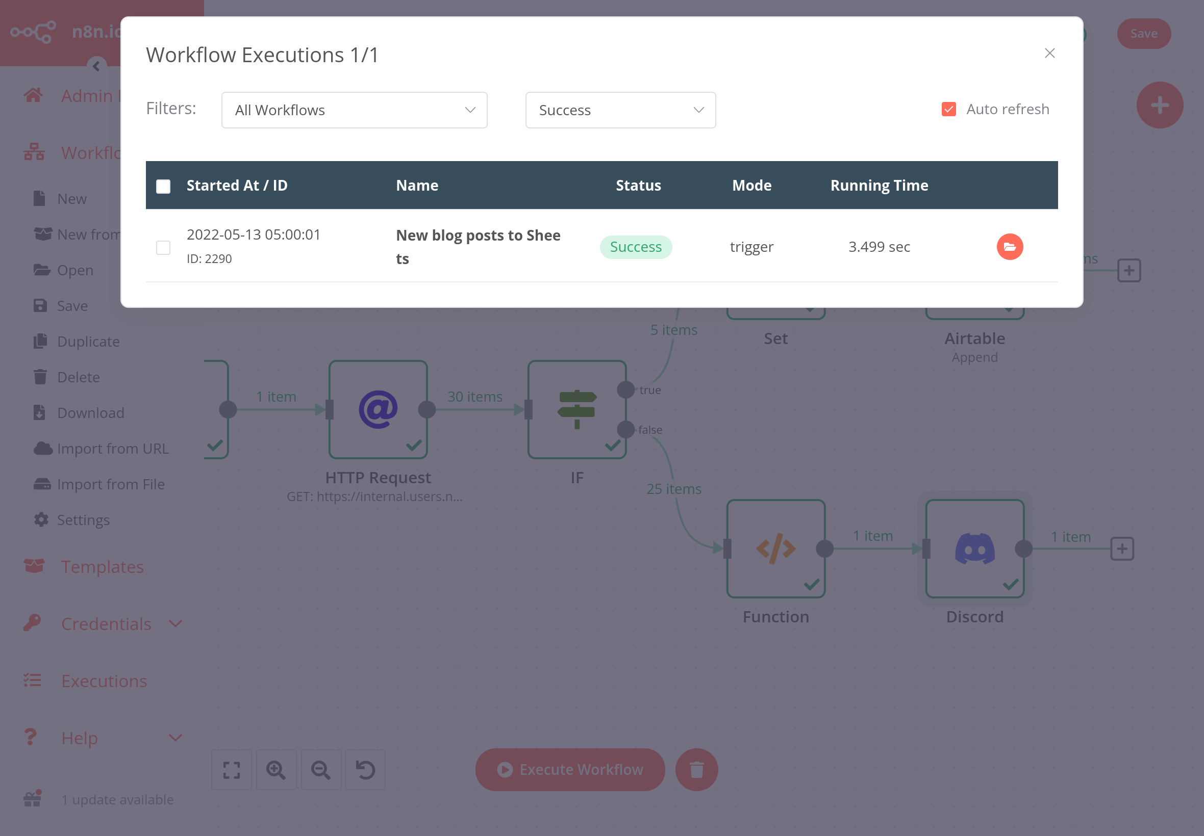

Workflow Executions
An execution represents a completed run of a workflow, from the first to the last node. n8n logs workflow executions, allowing you to see if the workflow was completed successfully or not. The execution log is useful for debugging your workflow and seeing at what stage it runs into issues.
To see the execution log, in your Editor UI click on Executions in the left panel. This will open the Workflow Executions window.
Workflow Execution List
The Workflow Executions window displays a table with the following information:
  • Name: The name of the workflow
  • Started At: The date and time when the workflow started
  • Status / Running time: The status of the workflow (Running, Succeeded or Error) / The duration it took the workflow to execute
  • Execution ID: The ID of this workflow execution
Workflow execution status
In the Workflow Executions window you can filter the displayed executions by workflow and by status (All, Error, Running, or Success). The information displayed here depends on what workflows and executions you set up in Workflow Settings to be saved.
