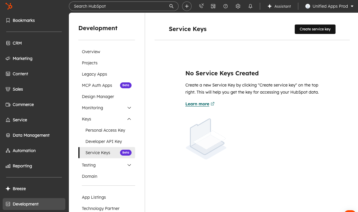

1. In your HubSpot account, go to **Development** > **Keys** > **Service Keys**. (You can also find **Service Keys** under **Settings** > **Account Management** > **Integrations** > **Service Keys**.)
   ![The Service Keys page in HubSpot's Development menu](https://139179334-files.gitbook.io/~/files/v0/b/gitbook-x-prod.appspot.com/o/spaces%2FBKcbOzIWja8NfqKDcqHc%2Fuploads%2Fgit-blob-df0fcc204b64eba6b712cfa60cdf40a323f91ed5%2Fservice_keys_main.png?alt=media)

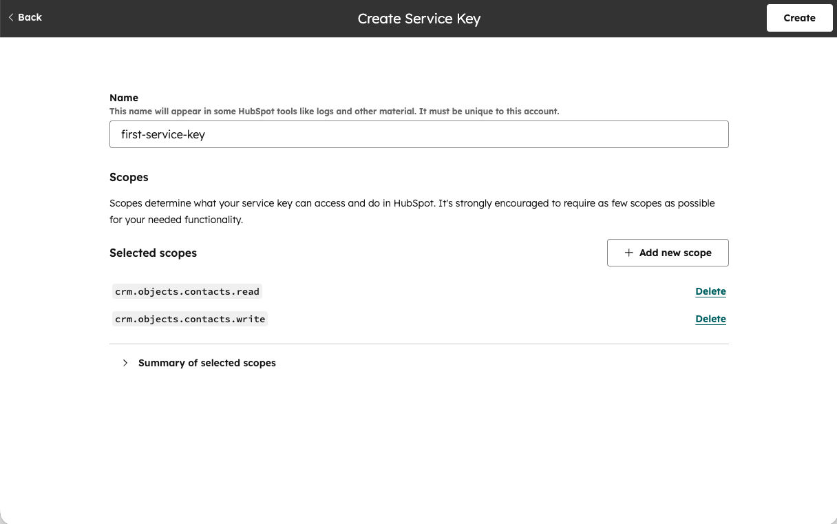

2. Select **Create service key**.
   ![The Create Service Key form with name and scopes fields](https://139179334-files.gitbook.io/~/files/v0/b/gitbook-x-prod.appspot.com/o/spaces%2FBKcbOzIWja8NfqKDcqHc%2Fuploads%2Fgit-blob-44bc64e3868dcc8e357ff952a0b9dd77c7422186%2Fservice_keys_create.png?alt=media)
3. Enter a descriptive **Name** for your key.
4. Select **Add new scope** and choose the permissions your integration needs. Refer to [Required scopes for HubSpot node](#required-scopes-for-hubspot-node) for a list of recommended scopes.
5. Select **Update** to confirm your scope selections.
6. Select **Create**, then confirm in the dialog.
7. Click on the new service key name to navigate to its details page, and select **Show** to reveal your key.
8. Copy the key value using the copy button, and paste it as the **App Token** in your n8n credential.
