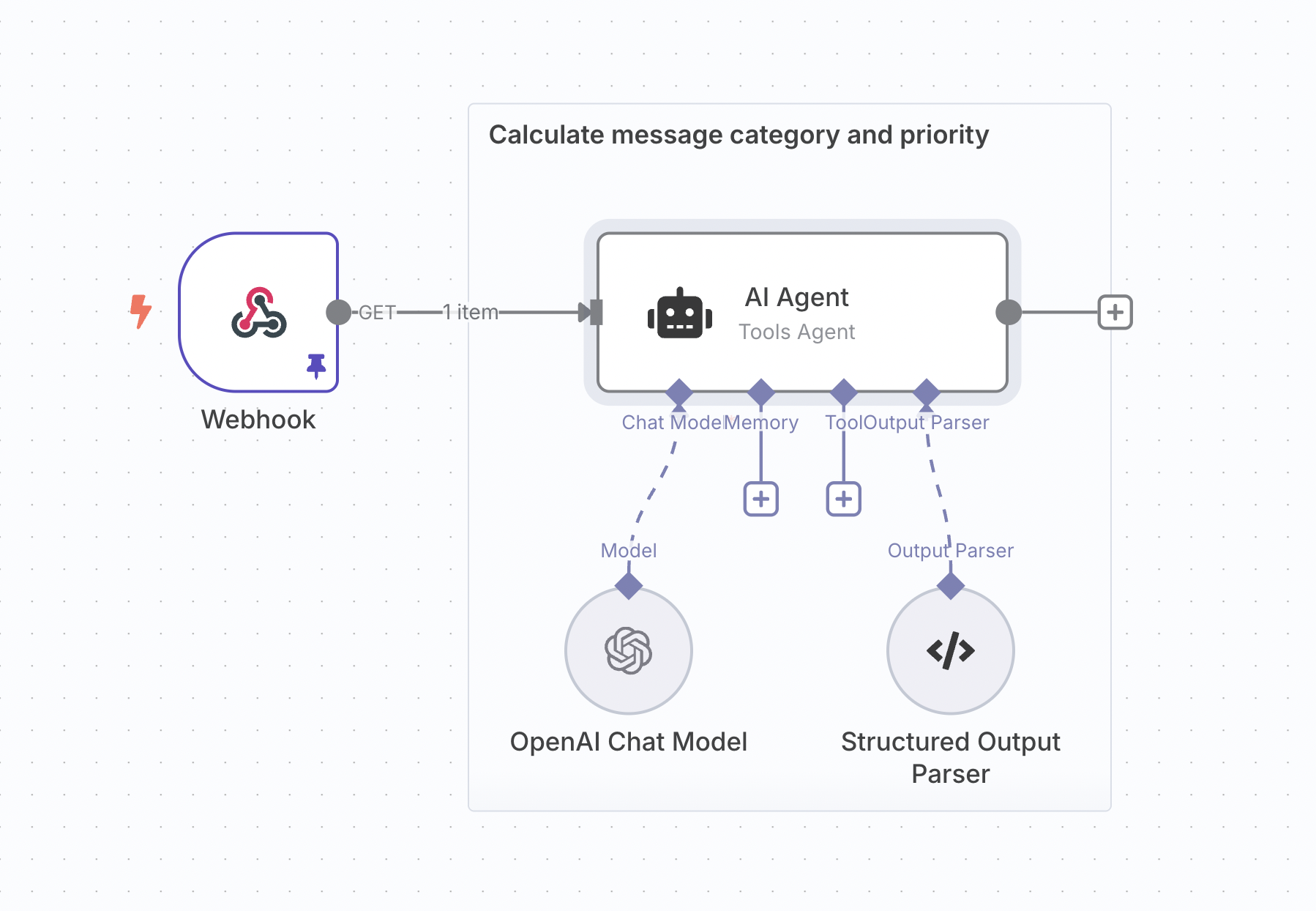

The following explanation will use a sample workflow that assigns a category and priority to incoming support tickets.
Example AI workflow

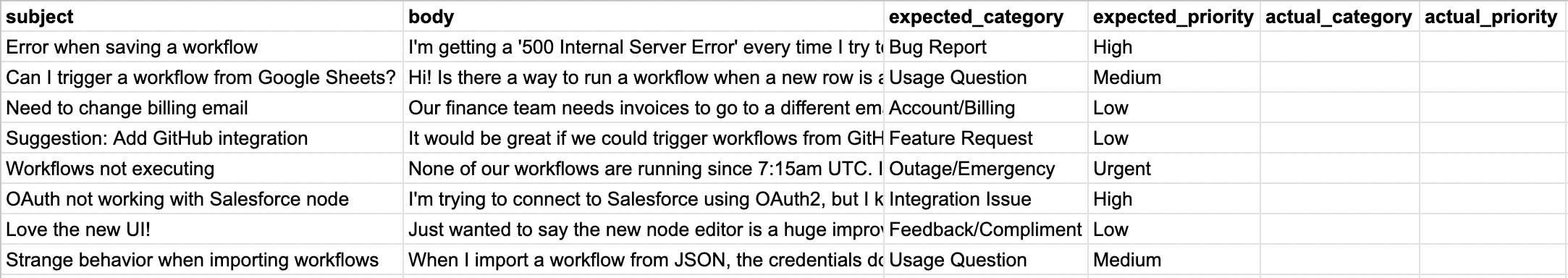

1. Create a dataset#
Create a Google Sheet with a handful of examples for your workflow. Your sheet should contain column(s) for:
  • The workflow input
  • (Optional) The expected or correct workflow output
  • The actual output
Leave the actual output column or columns blank, since you'll be filling them during the evaluation.
Sample dataset for a support ticket classification workflow
A sample dataset for the support ticket classification workflow.

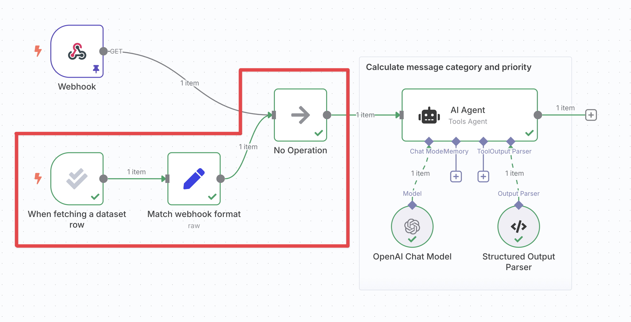

2. Wire the dataset up to your workflow#
Insert an evaluation trigger to pull in your dataset#
Each time the evaluation trigger runs, it will output a single item representing one row of your dataset.
Clicking the 'Evaluate all' button to the left of the evaluation trigger will run your workflow multiple times in sequence, once for each row in your dataset. This is a special behavior of the evaluation trigger.
While wiring the trigger up, you often only want to run it once. You can do this by either:
  • Setting the trigger's 'Max rows to process' to 1
  • Clicking on the 'Execute node' button on the trigger (rather than the 'Evaluate all' button)
Wire the trigger up to your workflow#
You can now connect the evaluation trigger to the rest of your workflow and reference the data that it outputs. At a minimum, you need to use the dataset’s input column(s) later in the workflow.
If you have multiple triggers in your workflow you will need to merge their branches together.
Connecting the evaluation trigger
The support ticket classification workflow with the evaluation trigger added in and wired up.

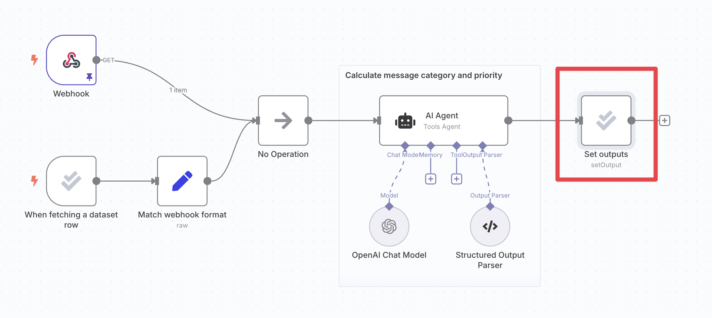

3. Write workflow outputs back to dataset#
To populate the output column(s) of your dataset when the evaluation runs:
  • Insert the 'Set outputs' action of the evaluation node
  • Wire it up to your workflow at a point after it has produced the outputs you're evaluating
  • In the node's parameters, map the workflow outputs into the correct dataset column
Connecting the set outputs node
The support ticket classification workflow with the 'set outputs' node added in and wired up.
