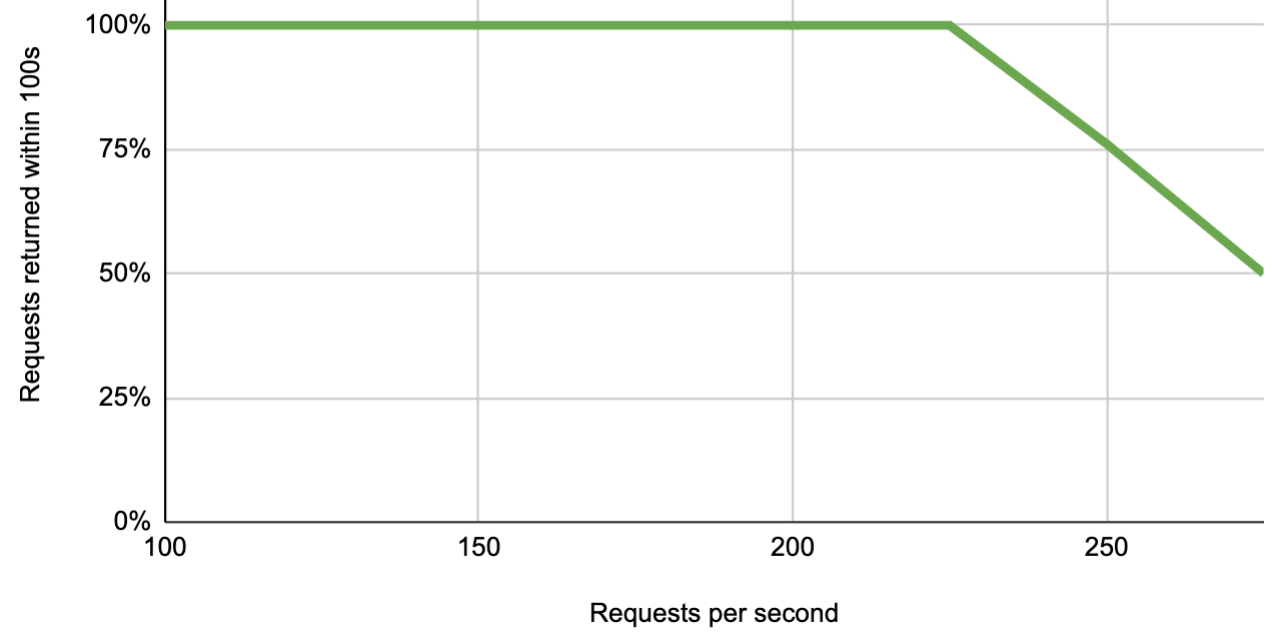

## Example: Single instance performance <a href="#example-single-instance-performance" id="example-single-instance-performance"></a>
This test measures how response time increases as requests per second increase. It looks at the response time when calling the Webhook Trigger node.
Setup:
* Hardware: ECS c5a.large instance (4GB RAM)
* n8n setup: Single n8n instance (running in main mode, with Postgres database)
* Workflow: Webhook Trigger node, Edit Fields node
<figure><img src="https://2773773108-files.gitbook.io/~/files/v0/b/gitbook-x-prod.appspot.com/o/spaces%2Fjm0ZYRpZIPWge2ZSiDYO%2Fuploads%2Fgit-blob-7006d3f0eff56e0b8421eb714bcfda8802e6d057%2Fbenchmarking-single-instance-100-250.png?alt=media" alt=""><figcaption><p>This graph shows the percentage of requests to the Webhook Trigger node getting a response within 100 seconds, and how that varies with load. Under higher loads n8n usually still processes the data, but takes over 100s to respond.</p></figcaption></figure>

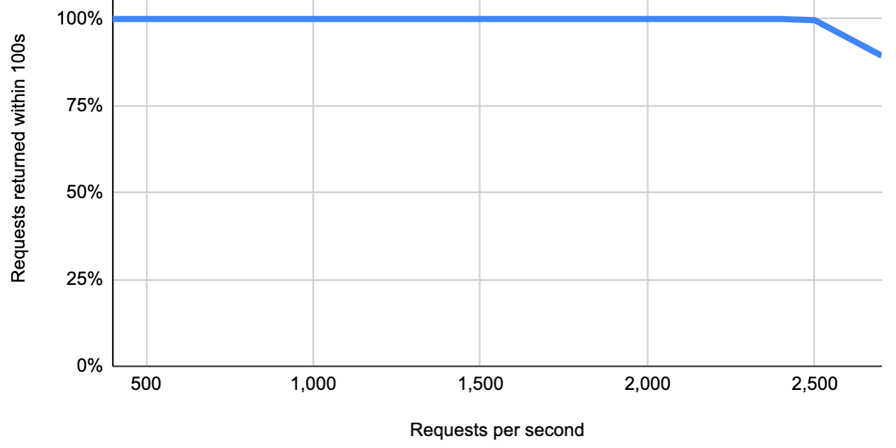

## Example: Multi-instance performance <a href="#example-multi-instance-performance" id="example-multi-instance-performance"></a>
Setup:
* Hardware: seven ECS c5a.4xlarge instances (8GB RAM each)
* n8n setup: two webhook instances, four worker instances, one database instance (MySQL), one main instance running n8n and Redis
* Multi-instance setups use [Queue mode](/deploy/host-n8n/configure-n8n/scaling/enable-queue-mode.md)
<figure><img src="https://2773773108-files.gitbook.io/~/files/v0/b/gitbook-x-prod.appspot.com/o/spaces%2Fjm0ZYRpZIPWge2ZSiDYO%2Fuploads%2Fgit-blob-d931a447da356364a78bdc3ead8585ca139d8dc1%2Fbenchmarking-multi-instance-500-2500.png?alt=media" alt=""><figcaption><p>This graph shows the percentage of requests to the Webhook Trigger node getting a response within 100 seconds, and how that varies with load. Under higher loads n8n usually still processes the data, but takes over 100s to respond.</p></figcaption></figure>
