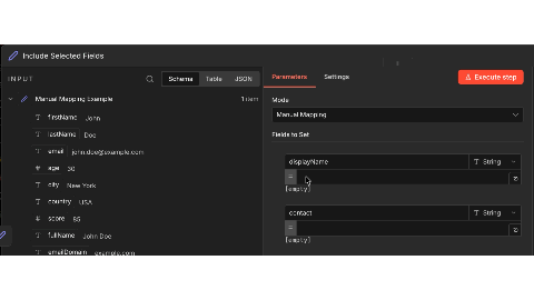

To build an expression in the UI, switch the field to expression mode, then drag a value from the **INPUT** pane into it, or type the expression directly.
![Toggling a field to Expression mode, then dragging a value from the INPUT pane to build the expression](https://3488703508-files.gitbook.io/~/files/v0/b/gitbook-x-prod.appspot.com/o/spaces%2FrPN1zU5jaYNvwH7RzxqA%2Fuploads%2Fgit-blob-2e7707b0b5912e2aacc361379751eb7c74a3d574%2FexpressionDot.gif?alt=media)
See [Expression reference](https://docs.n8n.io/build/work-with-data/transform-data/expression-reference.md) for more information and examples.
