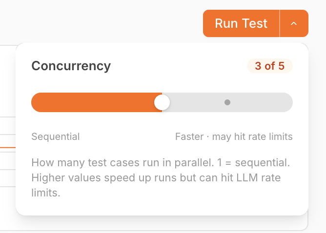

Run test cases in parallel
On plans that support concurrency, Run Test is a split-button. The caret to the right opens a popover with a slider that controls how many test cases run at the same time.
The concurrency popover, with the slider at 3 of a maximum of 5 parallel test cases.
The default maximum depends on your plan:
Plan
Maximum parallel test cases
Self-hosted Community, n8n Cloud Pro
1 (sequential)
Self-hosted Business
3
n8n Cloud Enterprise, self-hosted Enterprise
5
When the maximum is 1, the caret and popover are hidden and Run Test is a plain button — runs are sequential, identical to earlier versions.
Self-hosted instances can override the maximum with the N8N_CONCURRENCY_EVALUATION_LIMIT environment variable, regardless of plan tier.
LLM rate limits
Higher concurrency speeds up evaluation runs but increases the chance of hitting upstream LLM rate limits. If you see rate-limit errors, lower the slider.
