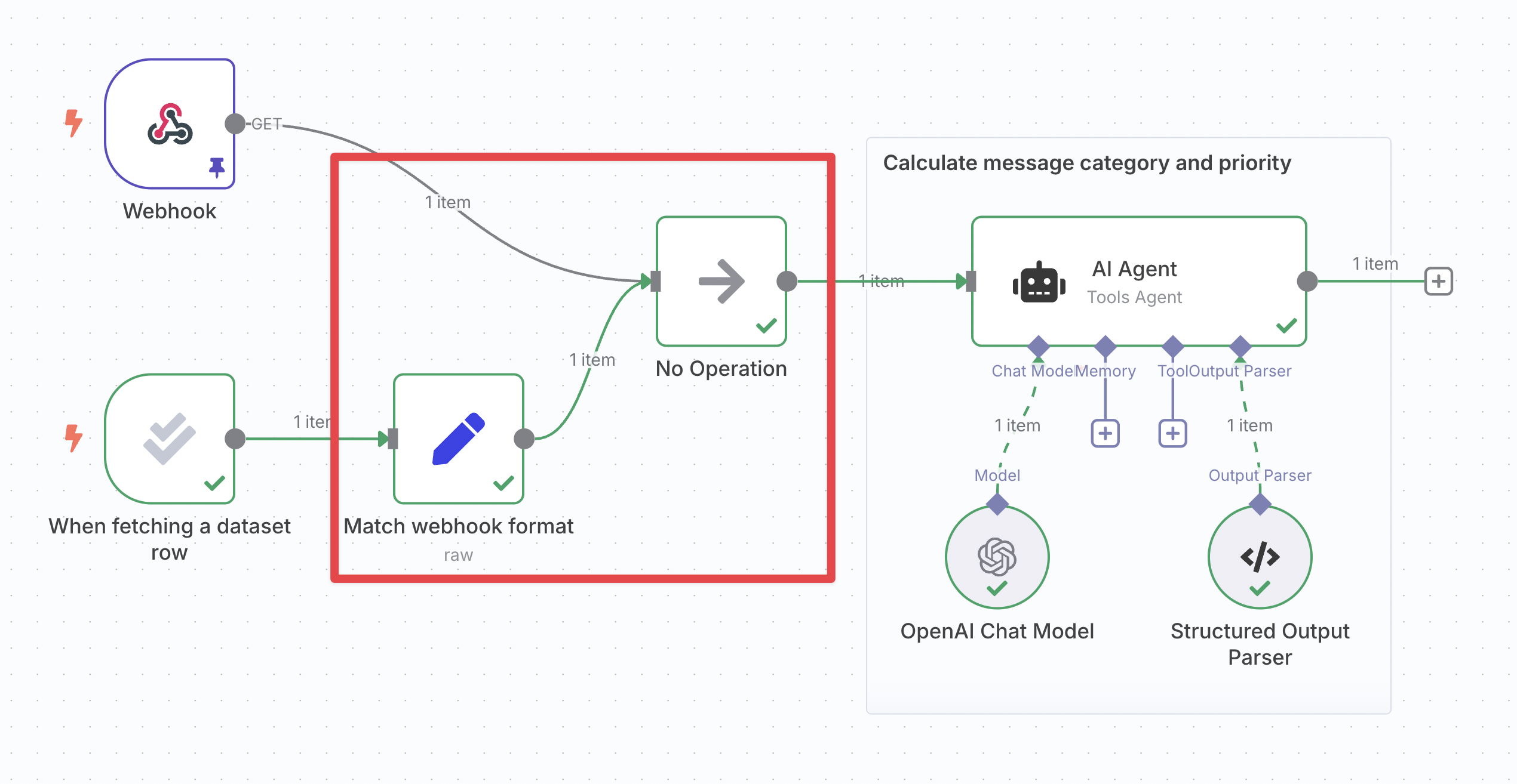

If you have another trigger in the workflow already, you have two potential starting points: that trigger and the [evaluation trigger](https://docs.n8n.io/integrations/builtin/core-nodes/n8n-nodes-base.evaluationtrigger.md). To make sure your workflow works as expected no matter which trigger executes, you will need to merge these branches together.
<figure><img src="https://3488703508-files.gitbook.io/~/files/v0/b/gitbook-x-prod.appspot.com/o/spaces%2FrPN1zU5jaYNvwH7RzxqA%2Fuploads%2Fgit-blob-bf42d36caace51c61a703fe9c79ca19e9fe472e8%2Fmerging-trigger-branches.png?alt=media" alt=""><figcaption><p>Logic to merge two trigger branches together so that they have the same data format and can be referenced from a single node.</p></figcaption></figure>
To do so:
1. **Get the data format of the other trigger**:
   * Execute the other trigger.
   * Open it and navigate to the JSON view of its output pane.
   * Click the **copy** button on the right.
2. **Re-shape the evaluation trigger data to match**:
   * Insert an [Edit Fields (Set) node](https://docs.n8n.io/integrations/builtin/core-nodes/n8n-nodes-base.set.md) after the evaluation trigger and connect them together.
   * Change its mode to **JSON**.
   * Paste your data into the 'JSON' field, removing the `[` and `]` on the first and last lines.
   * Switch the field type to **Expression**.
   * Map in the data from the trigger by dragging it from the input pane.
   * For strings, make sure to replace the entire value (including the quotes) and add `.toJsonString()` to the end of the expression.
3. **Merge the branches using a 'No-op' node**: Insert a [No-op node](https://docs.n8n.io/integrations/builtin/core-nodes/n8n-nodes-base.noop.md) and wire both the other trigger and the Set node up to it. The 'No-op' node just outputs whatever input it receives.
4. **Reference the 'No-op' node outputs in the rest of the workflow**: Since both paths will flow through this node with the same format, you can be sure that your input data will always be there.
