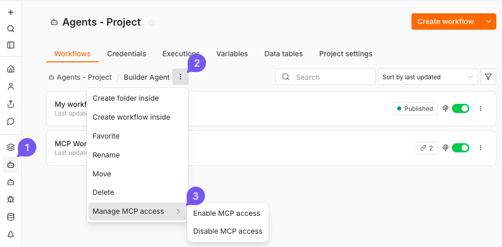

Enabling access for projects/folders#
Available from n8n v2.24.0
You can use the Options menu
in the workflow list to toggle MCP access for all workflows in the current project or folder:
- Navigate to the desired project and select Workflows from the top menu, then open a subfolder if required.
- Select the Options menu
next to the name of the project or folder. - Select Manage MCP access, then either Enable MCP or Disable MCP.
Note
This will toggle MCP access for all workflows that are currently in the selected project or folder (skipping ones that are already in the selected state). You will still need to toggle access for any workflows added in the future.
